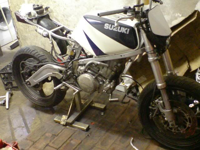

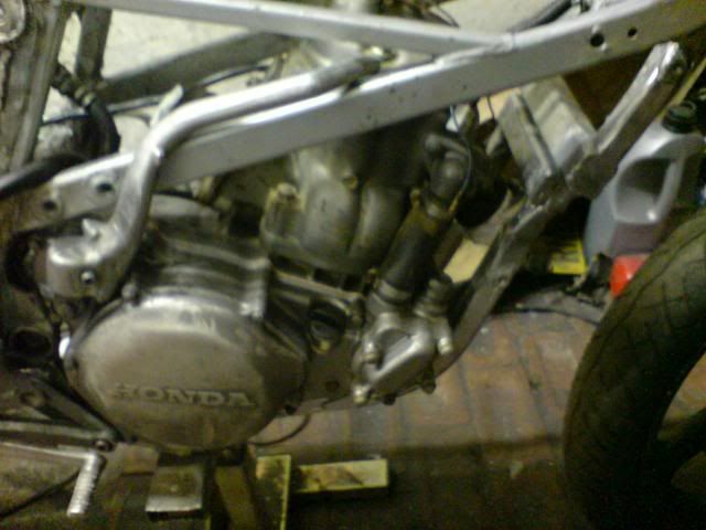

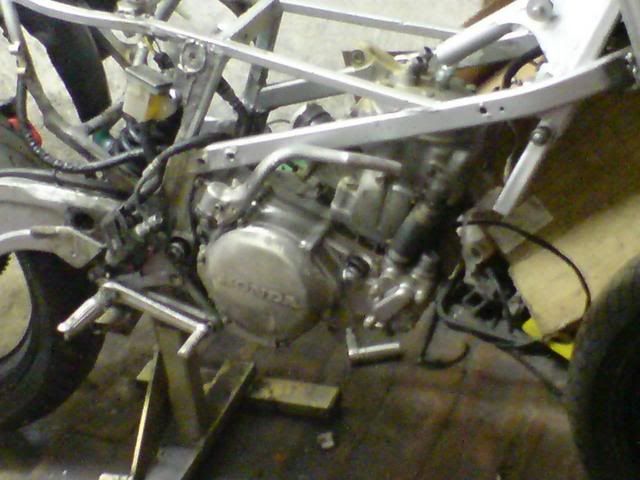

Howdi all, here are the first couple of pics of my 1989 RG125 Gamma with a 1995 CR500 engine in her. Spent a few hours on it this aft and got the engine a bit further on than in these pics. I have finished the top mount and braced the frame. Got the day off tomorrow, so I will take more pics whilst im working on her.
Latest pictures taken last night
