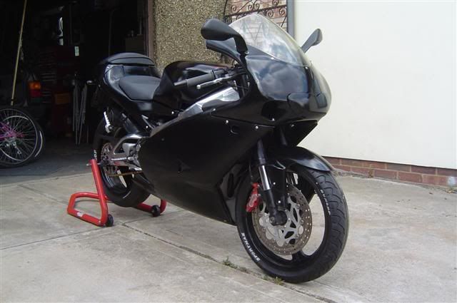

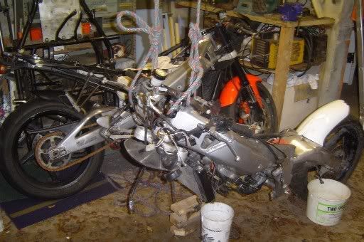

Obviously, the bike as I know it started life as a restoration project, purchased from Sunderland up north. This took some time, but eventually it went from this: (Bike hanging in foreground)
To this:
Then it suffered several serious engine problems over the summer, and I took it off the road. I then decided as, because I needed some kind of college project, to whack a 257 lump in it. I brought one of Chris, as well as the carb, ignition, front engine mounts, powervalve and a jolly moto exhaust that needed some work on.

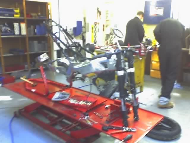

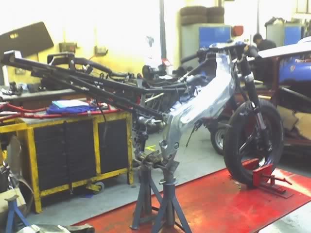

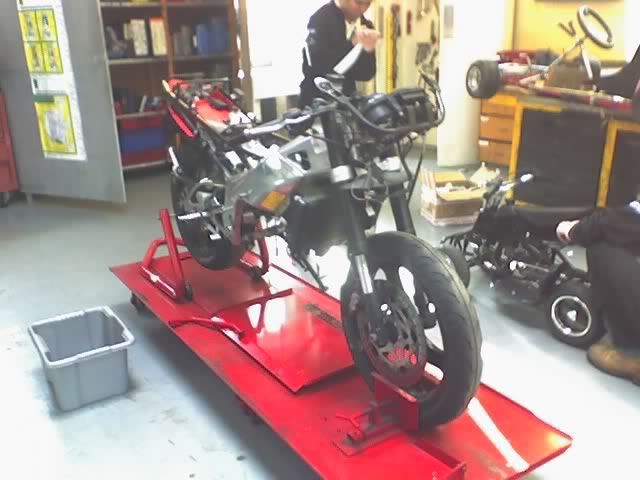

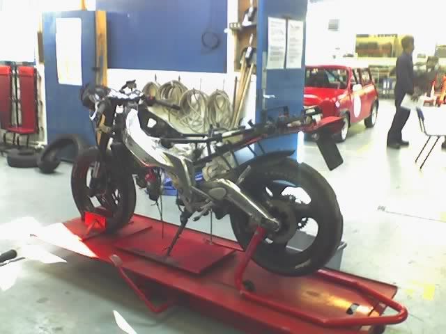

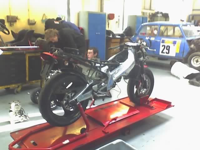

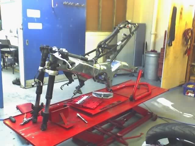

Anyway, first week, I didn't have the engine by this time, so I just stripped the bike down at college. I brought it in like this:
Later that day it looked like this
A 250 single will occupy this space soon!

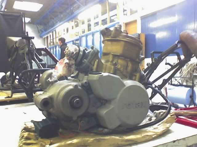

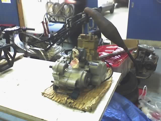

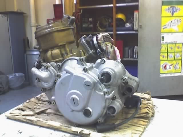

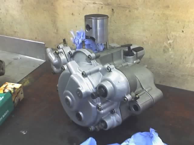

The next week, I had the engine. Here are some pics

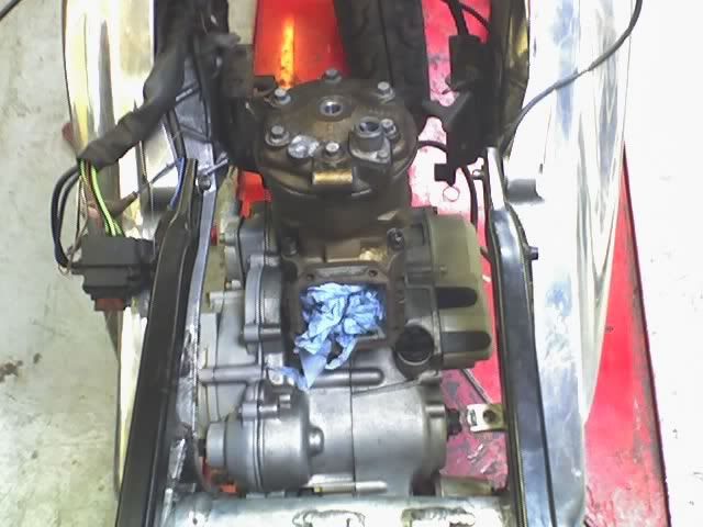

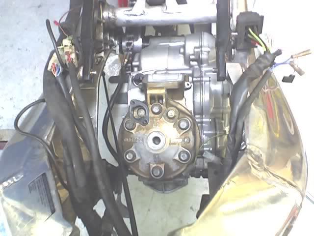

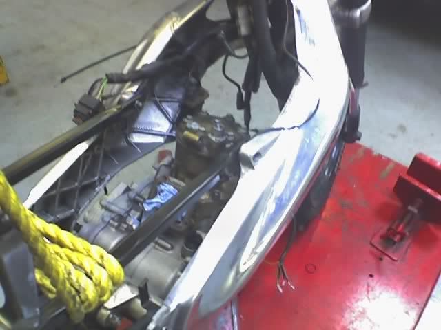

I then decided to put the engine in the bike, to get an idea of the work required to get it a correct fit

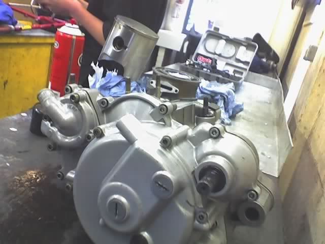

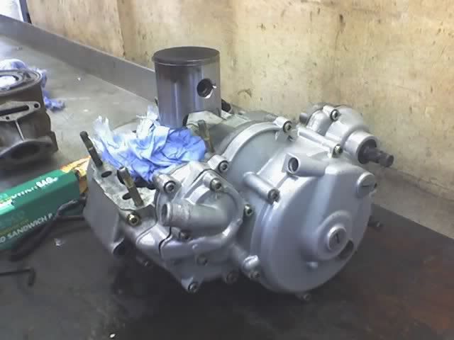

The week after, I took the top end off

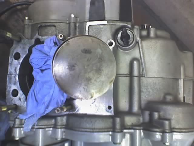

Decoking the piston: Before and after shots

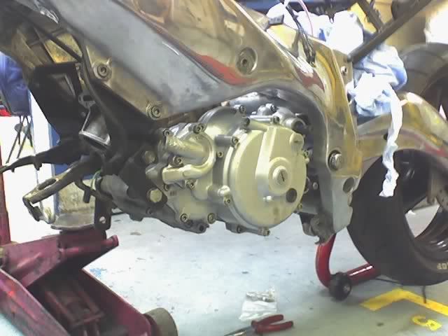

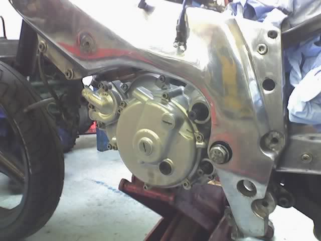

I then fitted the engine with the front engine mounts, meaning it was fitted with no support from jacks for the first time

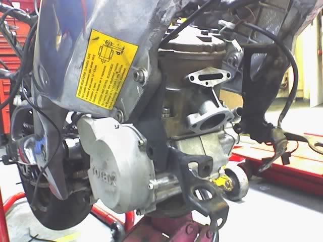

Another problem encountered, the water pump outlet comes out close to one of the front engine mounts, this will be sorted out later

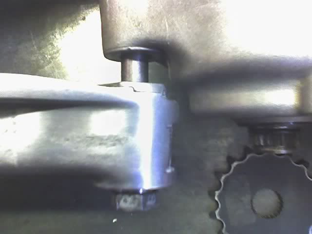

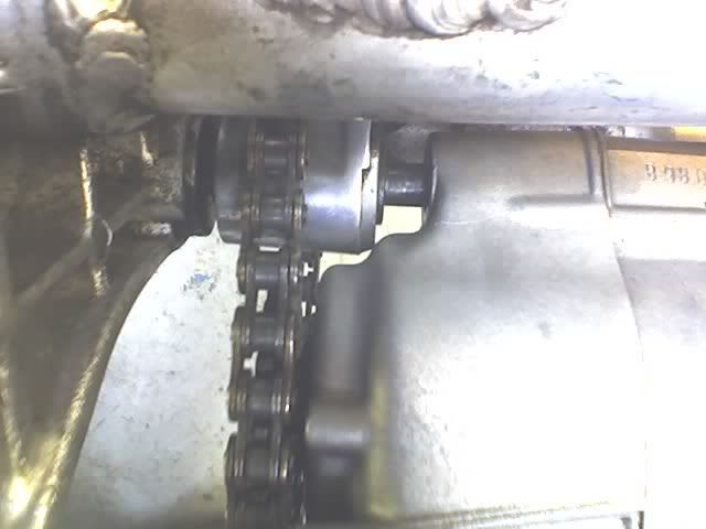

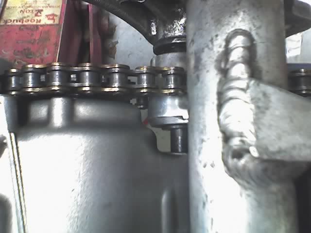

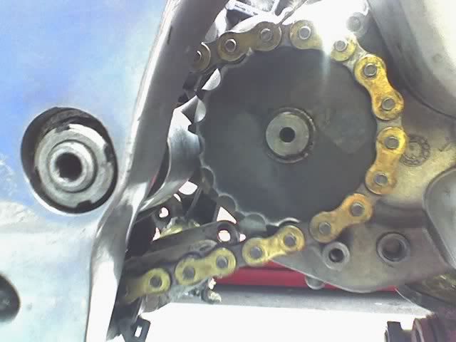

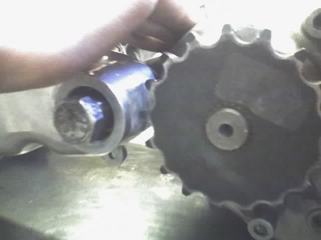

A few photos showing some problems we encounted when we fitted the engine. The front sprocket was hitting the swing arm, I am going to buy a smaller sprocket but the swingarm would need modifying aswell. The engine was also hitting the swingarm when trying to shuffle it along to align the chain. This meant I couldn't align the chain properly, so would need to be sorted out

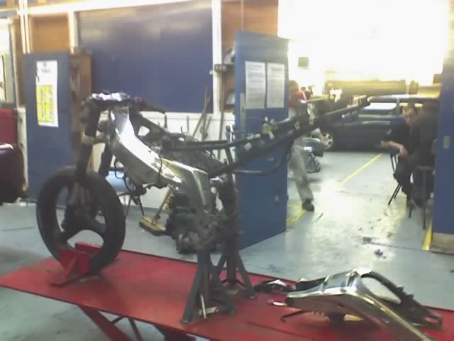

I then removed the swingarm to commence work on modifying it. This was how I finished the week

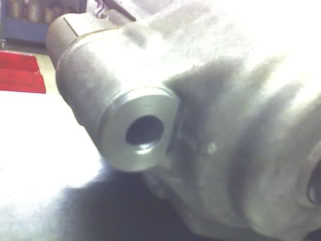

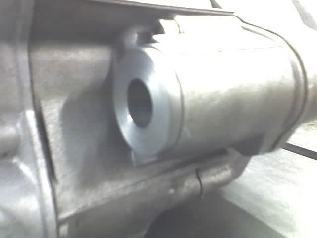

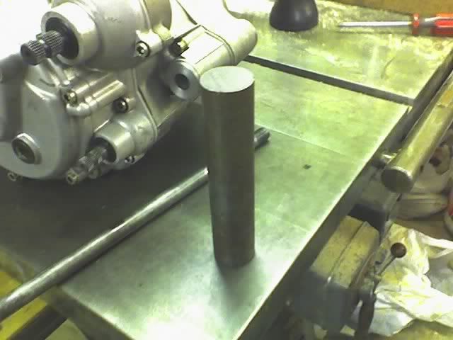

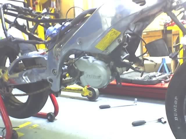

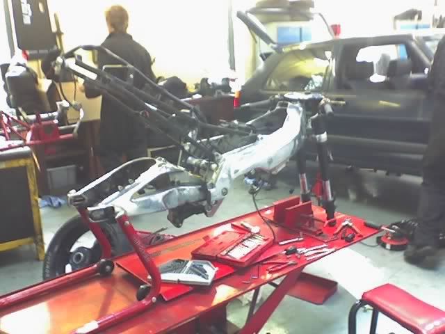

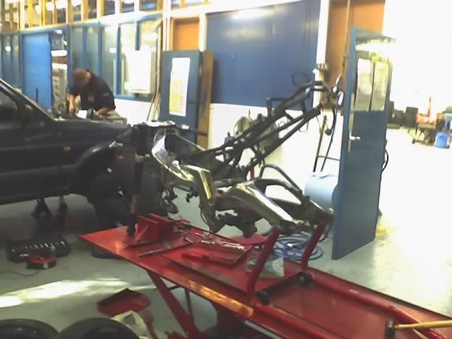

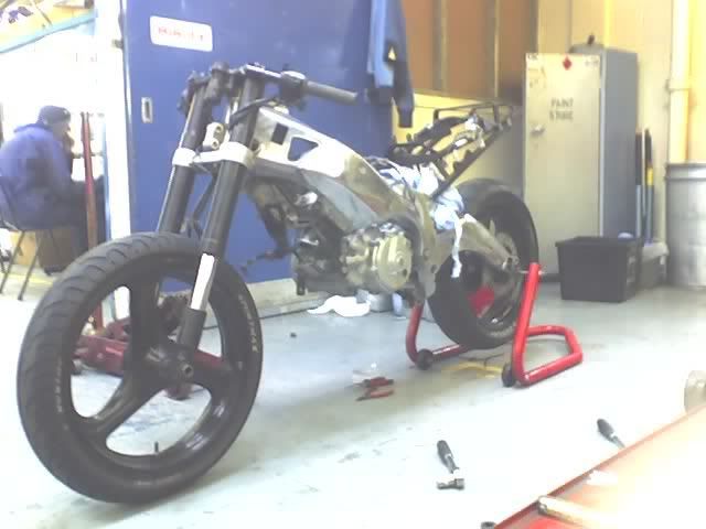

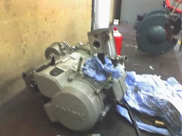

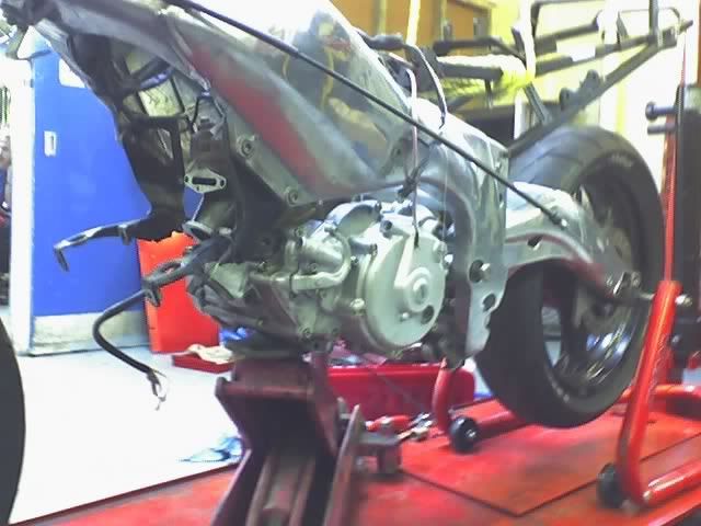

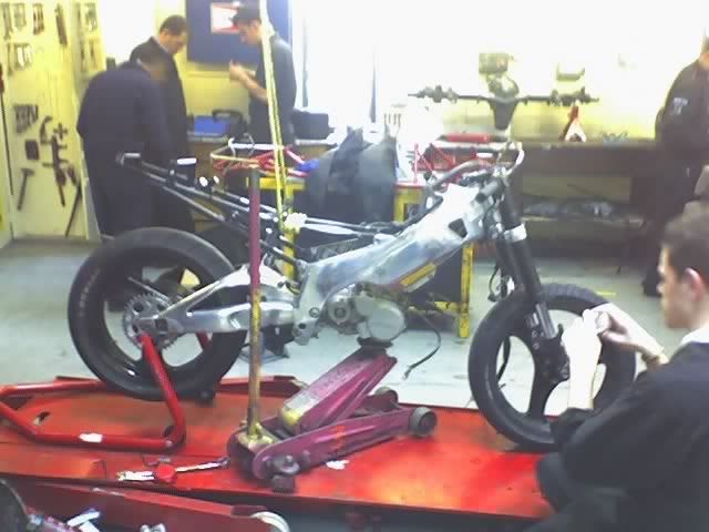

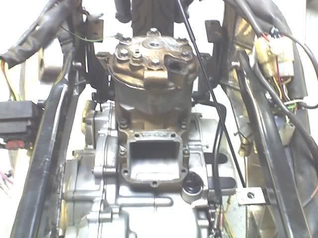

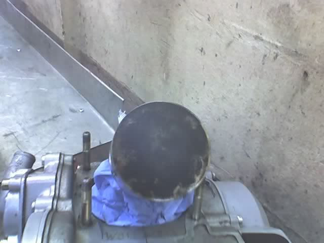

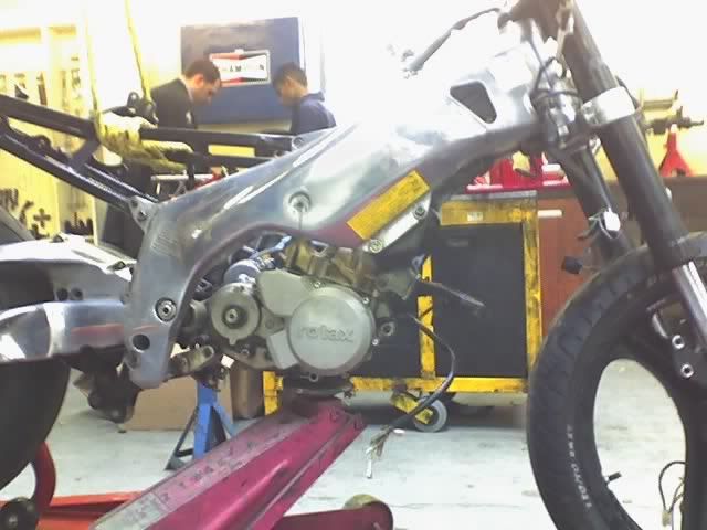

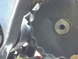

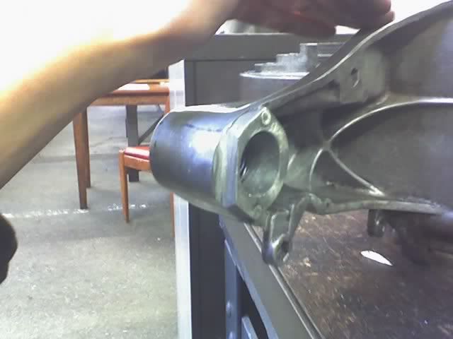

This week, I spent most of the day modifying the swing arm. I also had help making bushes for the rear engine mount, which would remove the play with the bolt fitted. This is what the bushes looked like before work, an ordinary lump of mild steel
Unfortunately I didn't get any pics of the bushes before I fitted them. But here they are fitted to the engine
This one had to be cut down to allow for the engine casing
Here are some pics of the swingarm after I had adjusted it, very happy with this
It now easily clears the engine with enough room for proper chain alignment
And the same for the sprocket
