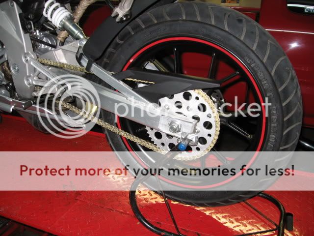

One of the simplest and most effective modifications to these bikes is a gearing change. They appear to be grossly overgeared from the factory and few can pull top gear well, even when derestricted. Changing to a lower final drive ratio absolutely transforms these bikes, making them accelerate much more quickly! There is a slight loss of ultimate top speed, but most can only obtain that speed on a looooong downhill grade. Lowering the final drive ratio makes the bike reach highway speeds with much greater ease under any conditions and makes around town speeds feel much more lively.
The bikes come with 16t front and 50t rear, in spite of the factory service manual indicating that standard gearing is 16t front and 57t rear! Getting the bike closer to the ratio indicated in the service manual is definitely a change for the better. Dropping the front sprocket one tooth (from 16 down to 15) is a quick, cheap fix and a step in the right direction.
It is my personal opinion however (and you know what they say about opinions) that this is not enough of a ratio change to truly make the most of the power output of these bikes. However, dropping to a 14t front sprocket puts too much stress on both the chain and the chain slipper on the swingarm. A better but pricier solution is to go with a 15t front and a 53 or 54t rear. If you're a smallish person, the 15/53 should prove to be a good combination. If you're a larger person, you may wish to go with a 54t rear. Note that going to a larger rear sprocket will also necessitate a longer chain which makes this an even pricier endeavor. This is not a bad thing though, as the standard chain appears to be of VERY poor quality and will be short lived anyway even with faithful care. This ratio change just gives you a good reason to buy a better quality chain. The standard chain is 428 x 130 links. Going to a smaller front sprocket and larger rear sprocket will require a chain at least 132 links in length, possibly 134 links if you go with the 54t rear. My personal GPR, derestricted and with an Arrow pipe, standard carb and jetting, and a 15/53 ratio will still pull 89 mph on top (GPS verified…the standard speedo is crap!). If you need to go faster than that on public roadways, you're a menace anyway.
Sprocket availability for this bike is nowhere near as good as say your average GSXR, but we won't go there. Front sprockets can be had by ordering for a Yamaha YZ85, (Thanks Banzairx7!) or by ordering from JT Sprockets . There doesn't appear to be any reasonable off-the-shelf replacement for the rear wheel sprocket. However, Rebel Gears in the United States has the specs for this sprocket, can make one with as many teeth as you like, and ships worldwide. Their alloy sprockets are strong, lightweight, and very attractive. I opted for the ultralight model, having far more lightening holes than their standard alloy sprocket. Turned out looking like this:
Should you wish to have a rear sprocket made by someone closer to you, the rear sprocket specs are as follows;
Flat - no offset
428 pitch
5 bolt pattern
Center hub hole diameter = 61.85 mm (2.435")
Bolt hole diameter = 10mm (0.394")
Distance from edge of hub hole to edge of bolt hole = 17.9 mm (0.705")
Distance from hub center to bolt hole center = 53.825 mm (2.12")
Any sprocket maker worth his salt should be able to make you a rear sprocket from these dimensions.
